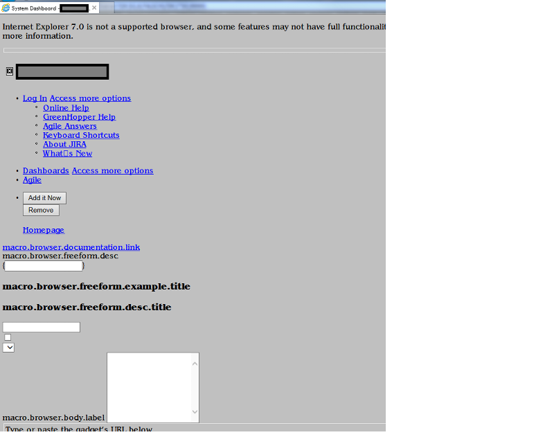

Author: Leo Torres replied at 2024-09-14 21:29:04
This is the site code here it is again
Here is what the page looks like
Any reason why you think this is not the code?
Expert: Qlemo replied at 2024-09-14 03:38:38
No, that is not the correct site code. It is the dashboard, and you need to click the "Log In" link to go to a login page.
