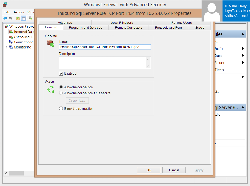

Expert: David Johnson, CD, MVP replied at 2024-07-28 06:17:31
200 points EXCELLENT
- 1

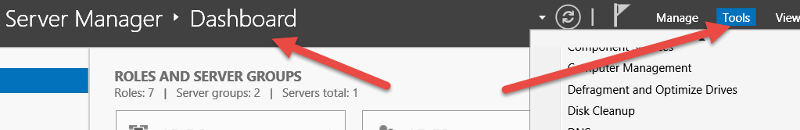

From Sever Manager Tools Bring up Windows Firewall with Advanced Services
- 2
Create a New Custom Rule or if you have an existing rule you can sort by port number i.e. 1434 and edit it
- 3
- 4
Add the program or service , here I checked service
- 5
Port and Protocol
- 6
Remote alow ip Addresses
- 7
The Profile you want this allow rule to be effective in
- 8
Apply, OK, You're done
