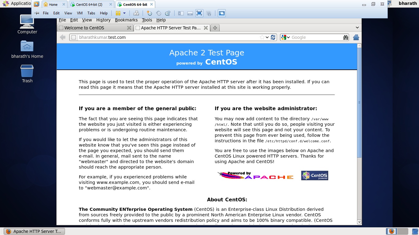

Author: BharathKumarRaju DasaraRaju replied at 2024-07-26 19:28:22
no problem..and thanks for your answers..
please find the attachment

Author: BharathKumarRaju DasaraRaju replied at 2024-07-26 18:01:05
i am running an linux machine inside vmware worksation. vmwware workstation has been installed in the my windows 7 machine. And i am connection the linux VM via ssh from putty from my windows7 machine
Expert: Gary replied at 2024-07-26 17:57:19
And are you running the terminal inside the VM?
What is inside Windows has nothing to do with the Linux VM

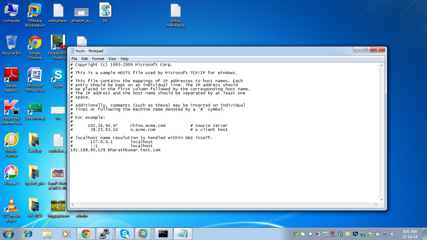

Author: BharathKumarRaju DasaraRaju replied at 2024-07-26 17:54:59
Hi Gary,
Actually the linux box running inside workstation. it won't be appear to web at all. I even edited the my hosts(windows7) machines hosts file as well. in my host machine in the browser itself it's not working as belwo..
[root@bharathkumar ~]# cat /etc/hosts
127.0.0.1 localhost localhost.localdomain localhost4 localhost4.localdomain4
::1 localhost localhost.localdomain localhost6 localhost6.localdomain6
192.168.80.129 bharathkumar.test.com

Connecting to bharathkumar.test.com|192.168.80.129|:80... connected.
HTTP request sent, awaiting response... 403 Forbidden
2014-07-26 17:42:27 ERROR 403: Forbidden.
Expert: Gary replied at 2024-07-26 17:42:29
Where is http://192.168.80.129/ coming from? That looks like a local/private IP address
Are you using your hosts file to redirect addresses?
Author: BharathKumarRaju DasaraRaju replied at 2024-07-26 17:35:02

Expert: Gary replied at 2024-07-26 17:29:19
Actually no this might not be a DNS propogation problem, I can connect to the IP but it is then redirecting. Unless there was a wrong IP or something set up initially
Is test.com your site?
What is your IP supposed to be?
50.23.225.49 and 208.64.121.188 both resolve to test.com

Expert: Gary replied at 2024-07-26 17:24:31
100 points EXCELLENT
Give it 24 hours and report back
Your browser could be using a different DNS than your terminal.
Author: BharathKumarRaju DasaraRaju replied at 2024-07-26 17:23:47
Hi Gary,
You are right ... might be your DNS propogation
Expert: Gary replied at 2024-07-26 17:19:20
In my browser I get redirected as well
This may just be a case of waiting for DNS propogation if this url is new.
Author: BharathKumarRaju DasaraRaju replied at 2024-07-26 17:17:23
Expert: Gary replied at 2024-07-26 17:14:37
This is the response I get
--2014-07-27 01:14:12-- http://bharathkumar.test.com/Resolving bharathkumar.test.com (bharathkumar.test.com)... 50.23.225.49Connecting to bharathkumar.test.com (bharathkumar.test.com)|50.23.225.49|:80... connected.HTTP request sent, awaiting response... 301 Moved PermanentlyLocation: http://www.test.com/ [following]--2014-07-27 01:14:12-- http://www.test.com/Resolving www.test.com (www.test.com)... 208.64.121.188Connecting to www.test.com (www.test.com)|208.64.121.188|:80... connected.HTTP request sent, awaiting response... 200 OKLength: 15174 (15K) [text/html]Saving to: ‘index.html’100%[=================================================>] 15,174 59.1KB/s in 0.3s2014-07-27 01:14:14 (59.1 KB/s) - ‘index.html’ saved [15174/15174]
1:2:3:4:5:6:7:8:9:10:11:12:13:14:15:
It's redirecting to www.test.com
Author: BharathKumarRaju DasaraRaju replied at 2024-07-26 17:01:47
Hi Gary,
Correct URL only... iam able to see the http test page with that URL in browser ....
[root@bharathkumar ~]# wget 192.168.80.129
--2014-07-26 16:52:18-- http://192.168.80.129/
Connecting to 192.168.80.129:80... connected.
2014-07-26 16:52:18 ERROR 403: Forbidden.
