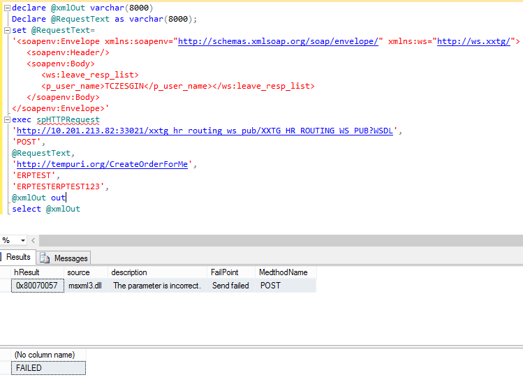

Sql in call web service
Asked by snnege
at 2024-11-26 04:49:38
Point:500 Replies:1 POST_ID:828827USER_ID:10
MS SQL Server;;SQL Server 2008
MY SP
CREATE proc [dbo].[spHTTPRequest] @URI varchar(2000) = '', @methodName varchar(50) = '', @requestBody varchar(8000) = '', @SoapAction varchar(255), @UserName nvarchar(100), -- DomainUserName or UserName @Password nvarchar(100), @responseText varchar(8000) outputasSET NOCOUNT ONIF @methodName = ''BEGIN select FailPoint = 'Method Name must be set' returnENDset @responseText = 'FAILED'DECLARE @objectID intDECLARE @hResult intDECLARE @source varchar(255), @desc varchar(255)EXEC @hResult = sp_OACreate 'MSXML2.ServerXMLHTTP', @objectID OUTIF @hResult <> 0BEGIN EXEC sp_OAGetErrorInfo @objectID, @source OUT, @desc OUT SELECT hResult = convert(varbinary(4), @hResult), source = @source, description = @desc, FailPoint = 'Create failed', MedthodName = @methodName goto destroy returnEND-- open the destination URI with Specified methodEXEC @hResult = sp_OAMethod @objectID, 'open', null, @methodName, @URI, 'false', @UserName, @PasswordIF @hResult <> 0BEGIN EXEC sp_OAGetErrorInfo @objectID, @source OUT, @desc OUT SELECT hResult = convert(varbinary(4), @hResult), source = @source, description = @desc, FailPoint = 'Open failed', MedthodName = @methodName goto destroy returnEND-- set request headersEXEC @hResult = sp_OAMethod @objectID, 'setRequestHeader', null, 'Content-Type', 'text/xml;charset=UTF-8'IF @hResult <> 0BEGIN EXEC sp_OAGetErrorInfo @objectID, @source OUT, @desc OUT SELECT hResult = convert(varbinary(4), @hResult), source = @source, description = @desc, FailPoint = 'SetRequestHeader failed', MedthodName = @methodName goto destroy returnEND-- set soap actionEXEC @hResult = sp_OAMethod @objectID, 'setRequestHeader', null, 'SOAPAction', @SoapActionIF @hResult <> 0BEGIN EXEC sp_OAGetErrorInfo @objectID, @source OUT, @desc OUT SELECT hResult = convert(varbinary(4), @hResult), source = @source, description = @desc, FailPoint = 'SetRequestHeader failed', MedthodName = @methodName goto destroy returnENDdeclare @len intset @len = len(@requestBody)EXEC @hResult = sp_OAMethod @objectID, 'setRequestHeader', null, 'Content-Length', @lenIF @hResult <> 0BEGIN EXEC sp_OAGetErrorInfo @objectID, @source OUT, @desc OUT SELECT hResult = convert(varbinary(4), @hResult), source = @source, description = @desc, FailPoint = 'SetRequestHeader failed', MedthodName = @methodName goto destroy returnEND/*-- if you have headers in a table called RequestHeader you can go through them with thisDECLARE @HeaderKey varchar(500), @HeaderValue varchar(500)DECLARE RequestHeader CURSORLOCAL FAST_FORWARDFOR SELECT HeaderKey, HeaderValue FROM RequestHeaders WHERE Method = @methodNameOPEN RequestHeaderFETCH NEXT FROM RequestHeaderINTO @HeaderKey, @HeaderValueWHILE @@FETCH_STATUS = 0BEGIN --select @HeaderKey, @HeaderValue, @methodName EXEC @hResult = sp_OAMethod @objectID, 'setRequestHeader', null, @HeaderKey, @HeaderValue IF @hResult <> 0 BEGIN EXEC sp_OAGetErrorInfo @objectID, @source OUT, @desc OUT SELECT hResult = convert(varbinary(4), @hResult), source = @source, description = @desc, FailPoint = 'SetRequestHeader failed', MedthodName = @methodName goto destroy return END FETCH NEXT FROM RequestHeader INTO @HeaderKey, @HeaderValueENDCLOSE RequestHeaderDEALLOCATE RequestHeader*/-- send the requestEXEC @hResult = sp_OAMethod @objectID, 'send', null, @requestBodyIF @hResult <> 0BEGIN EXEC sp_OAGetErrorInfo @objectID, @source OUT, @desc OUT SELECT hResult = convert(varbinary(4), @hResult), source = @source, description = @desc, FailPoint = 'Send failed', MedthodName = @methodName goto destroy returnENDdeclare @statusText varchar(1000), @status varchar(1000)-- Get status textexec sp_OAGetProperty @objectID, 'StatusText', @statusText outexec sp_OAGetProperty @objectID, 'Status', @status outselect @status, @statusText, @methodName-- Get response textexec sp_OAGetProperty @objectID, 'responseText', @responseText outIF @hResult <> 0BEGIN EXEC sp_OAGetErrorInfo @objectID, @source OUT, @desc OUT SELECT hResult = convert(varbinary(4), @hResult), source = @source, description = @desc, FailPoint = 'ResponseText failed', MedthodName = @methodName goto destroy returnENDdestroy: exec sp_OADestroy @objectIDSET NOCOUNT OFFGO

Expert: duncanb7 replied at 2024-12-01 03:16:57
change MSXML2.ServerXMLHTTP to MSXML2.ServerXMLHTTP.6.0 or other version value
like 5.0 or 3.0 for cross-check
You can use dos command of "regedit" to check what the value at HKEY_CLASSES_ROOT in the regsitry you have .Most linkly, you 've MSXML2.ServerXMLHTTP.6.0
Please take a look on this if have time
http://www.experts-exchange.com/Microsoft/Development/MS-SQL-Server/SQL_Server_2008/Q_28045828.html
Hope understand your question completely. If not , please pt it out
