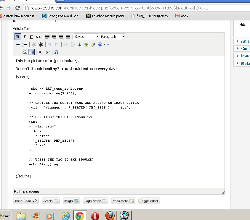

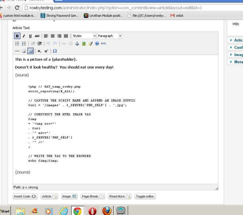

Expert: Ray Paseur replied at 2024-08-04 14:20:51
Hi, Rowby.
Line 7 says this:
?php // RAY_temp_rowby.php
Change that to this:
<?php // RAY_temp_rowby.php
Line 23 says this:
echo $img;$img;
echo $img; ?>
Not sure if this is 100% right but I think we are getting closer.
Line 7 says this:
Line 23 says this:
echo $img;$img;
echo $img; ?>
Author: rowby replied at 2024-08-04 14:10:40
This is what the code looks in my wyswyg editor (HTML view -- not source).

Expert: Ray Paseur replied at 2024-08-04 13:27:10
Looks like the <?php tag that starts the PHP interpreter was some how damaged because there is PHP code written into the HTML stream.
Let's try this. Please post the entire script that generates this page. Just copy/paste into the code snippet. If there are any passwords or anything like that, feel free to obscure them, but post as true, correct and complete version of the script as you possibly can. I'll see if I can figure out a place to put the PHP code.

Not 100 percent sure what to do with your script.
I have tried this: http://rowbytesting.com/RAY_temp_rowby.php
I also inserted the code into my joomla page (with a plugin that allows me to insert php into an article: http://rowbytesting.com/banana
Of course that didn't work. I realize I am missing something :)
So just so I am clear
If the page is named http://rowbytesting.com/ banana it would automatically put in the image already located in /images/banana.jpg into a placeholder on the page.
If the page is named http://rowbytesting.com/apples-and-orange it would put in the image already located in /images/apples-and-oranges.jpg into a placeholder on the page.
I want the php to "see" the url and automatically put the image into the placeholder.
There will be only one image per page.
Rowby
Expert: Ray Paseur replied at 2024-08-04 11:36:40
Install this using any script name you want, and run it, then use "view source" to look at what it produces. You might want to use ltrim() to remove a leading slash from the script name - that will depend on your file system structure.
<?php // RAY_temp_rowby.phperror_reporting(E_ALL);// CAPTURE THE SCRIPT NAME AND APPEND AN IMAGE SUFFIX$uri = $_SERVER['PHP_SELF'] . '.jpg';// CONSTRUCT THE HTML IMAGE TAG$img= '<img src="'. $uri. '" alt="'. $_SERVER['PHP_SELF']. '" />';// WRITE THE TAG TO THE BROWSERecho $img;
1:2:3:4:5:6:7:8:9:10:11:12:13:14:15:16:17:
Best regards, ~Ray
