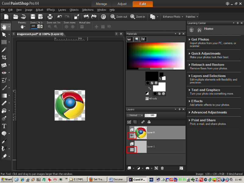

I have just explained this - you don't need to delete grey layer, but you didn't click with mouse on a "eye" on the left side of grey layer. And the result is that you save a PNG with 2 layers and of course you have got a PNG with grey background.
Look at the image of Paint Shop PRO above. I marked with red rectangular upper layer that has "EYE" sign turn on.
But look then at the layer bellow with grey colour. I clicked with the mouse on the "EYE" sign near this layer and you can't see "EYE" sign anymore !!! Look at the image when you disable grey layer - it is a transparent ! How you can know this?
Very easy. All graphic editors have the same area that represent transparency - the grey and white boxes that represent transparent area. It looks like a chess table, but the black boxes are replaced with grey boxes. It is a normal standard for graphic programs to show a transparent area in that way.

No, PNG isn't a kind of files that support layers. You can open PSD file and then delete a grey layer and select a File menu, choose a Save as and select file type to be PNG and then you can save image in that format. But, I must explain something. If you open a Photoshop PSD file in Paint Shop PRO then it is enough to click on the "eye" little button on the left side of a grey layer and you will get only a Chrome layer that is transparent and you can go to Save as and save this as a PNG file.
You don't need to DELETE grey layer. If you turn off grey layer the Paint Shop PRO will see only upper layer with Chrome symbol and you can save this as transparent PNG:
