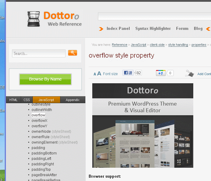

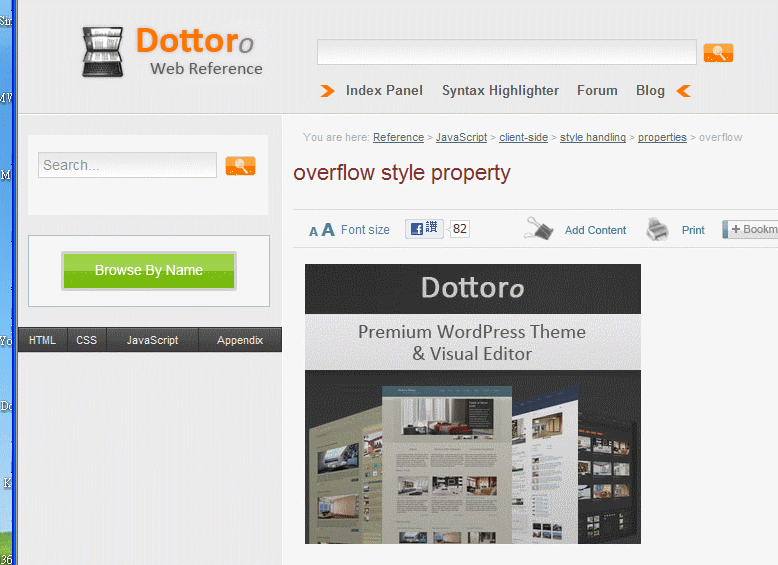

any menu bar icon can NOT be click-ed at area around "HOME CSS Javascript Appendix" and report javascript error
on line 105, Tree.active.Tree is undefined from FireBug in firefox when one of menu icon is clicked.
So I made a test, save the php curl output in Firefox into ANSI file such as C:curloutput.html and run it in FIrefox and
the problem is gone and any click on the menu bar is activated. this test proves the problem is NOT related to
path or domain name issue since all full domain and path name is specified in all related tag in html after viewing its html code.
And also try to send "curloutput .html" into my server, and run it in Firefox at www.mysite.com/curloutput.html but the problem is
coming out again and menu bar click is not working again You can see in problem.gif, we can not be able to see sub menu at menu bar,
Normally, we should see the sub menu bar like correct.gif attached
So now I suspect the issue at my curl() function and the syntax
