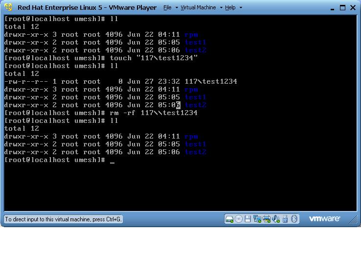

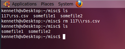

Expert: kaufmed replied at 2024-06-27 09:32:53
Is it possible to post a screenshot of a "ls" command?
Here is what my test looked like:

Expert: kaufmed replied at 2024-06-27 08:15:45
Try doubling up the slash:
