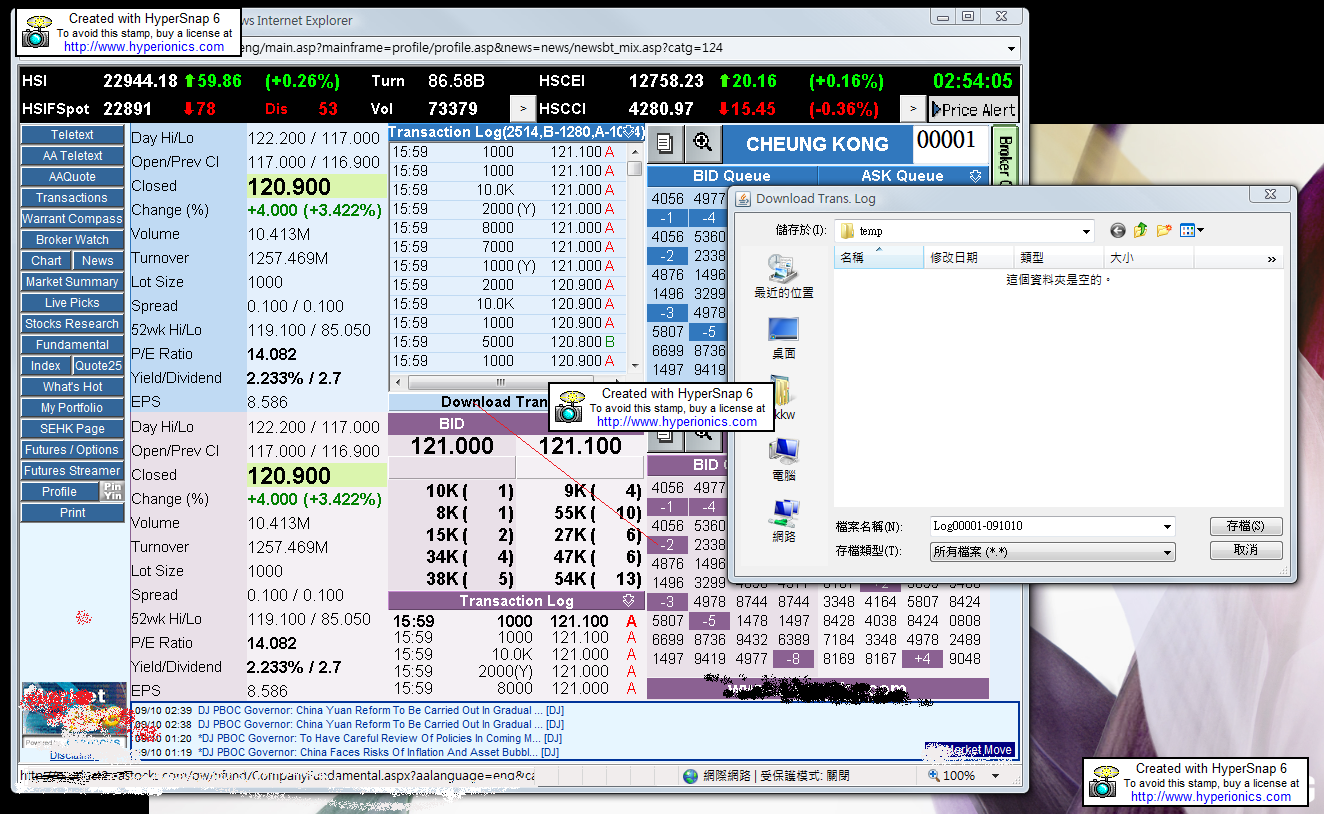

I tried to use Window API method to replace Sleep() like bGetwindows() subroutine code below
to get the window title and check whether the popup window is ready or not but it always report
the first data webpage and not foreground windows information. I use debug.print to print
out mystr variable, it report title of " *****-WIndows Internet Explorer" and not the one I want
that is "Download Trans.Log" Please view the Two windows image and be reminded the small Java windows
is forground windows of data website paga or on the top of webiste page by click the download bar in first
website page. Please ignore the screen capture stamp.

Finally it is solved that root cause is not related to Java or Parent/Child issue/
Actually it is related to sending enter too faster than the "Download Trans.log" popup
window comes out. Now it is okay using bGetwindow_click and put back those
setcursorpos and leftdown clikc in the loop that will help a lot . ANyway, think a lot
